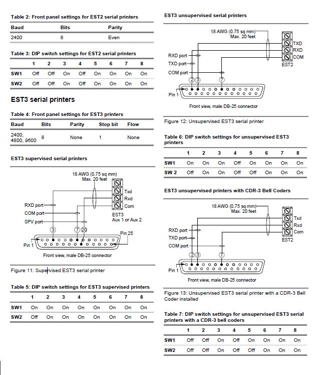

I would like connect printer to est-3. I try connection based
on manual from printer est pt-1 but printer not working.
What is proper connection and setup of printer.
Peter

-check that the 3-RS232 optional card is installed correctly
-check the proper configuration to port1 port2 in SDU.
regards...

What is proper setup of the sdu?

in cabinet configuration
-PORTS:
-port 1 or 2 type PRINTER OR SUPERVISED PRINTER (same as PT1 connection)
-baud rate (same as PT1 settings)
save project
regards...
Re: printer connection
PT Series Printers
est3-est2-qs3100989_R1_PT_Series_Printers.pdf
(304.83 KiB) Downloaded 1322 times

Do you have the pin out data for the DB9 connector for capturing info to a laptop, and is the hyperterm settings the same as for the printer on the attached file.
