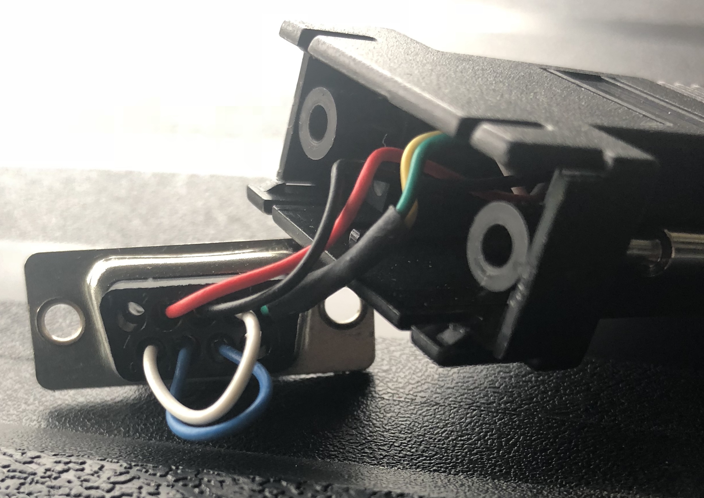

There is more going on than just 3 pins. On the serial end there are some pin jumpers together. I will take pictures of my cable later tonight. Other thing the program defaults to com 1 if your usb isn't on com 1 it's not going to work. The software only gives you access to com 1 or 2

Awesome, that would be greatly appreciated. I do have it set to com1 and there's communication on the transmit pin but I don't have any jumpers so maybe that's the issues. Thanks

Doug, you're awesome. It worked like a charm! Thank you very much.

For those who still need the cable information, I discovered that this uses the same programming cable as the Gamewell 600 series. This is a female DB-9 to modular 4P4C plug, like a traditional phone handset cable, not RJ-11. RJ-11 will be too wide to fit into the jack. The pins are as follows:
Code: Select all
DB-9 -- 4P4C
1 -- Unused
2 -- 2
3 -- 1
4 -- Jumper to DB-9 6
5 -- 3 + 4
6 -- Jumper to DB-9 4
7 -- Jumper to DB-9 8
8 -- Jumper to DB-9 7
9 -- Unused
