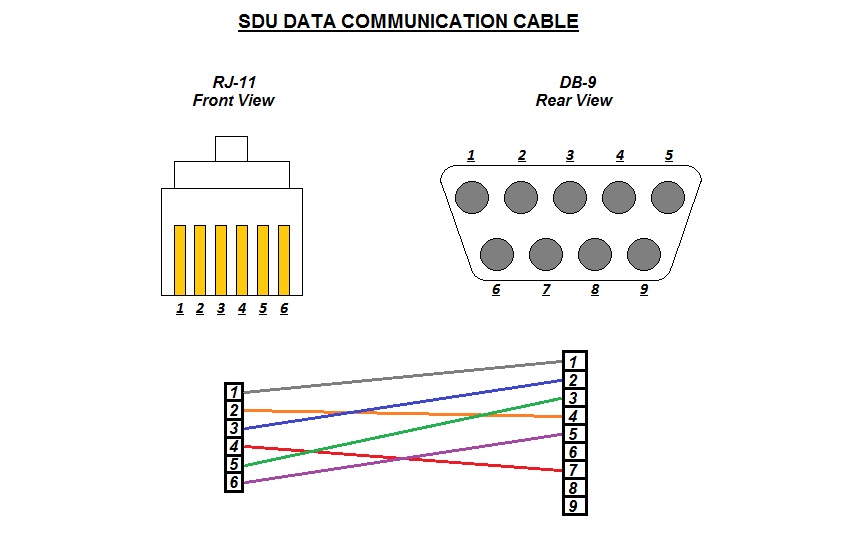

Hello,
I lost my cable and would you like to make another cable, but i don't have the pinouts between RJ-11 conector and DB-9 conector.
How can i do this ?
Thanks.
EST3 - SDU lost communication cable - PINOUTS

Re: SDU lost communication cable - PINOUTS
THIS IS THE PINOUTS.
SEE FILE.
REGARDS.
SEE FILE.
REGARDS.
