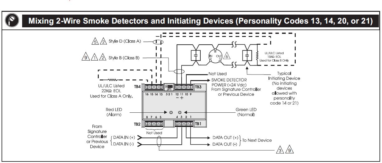

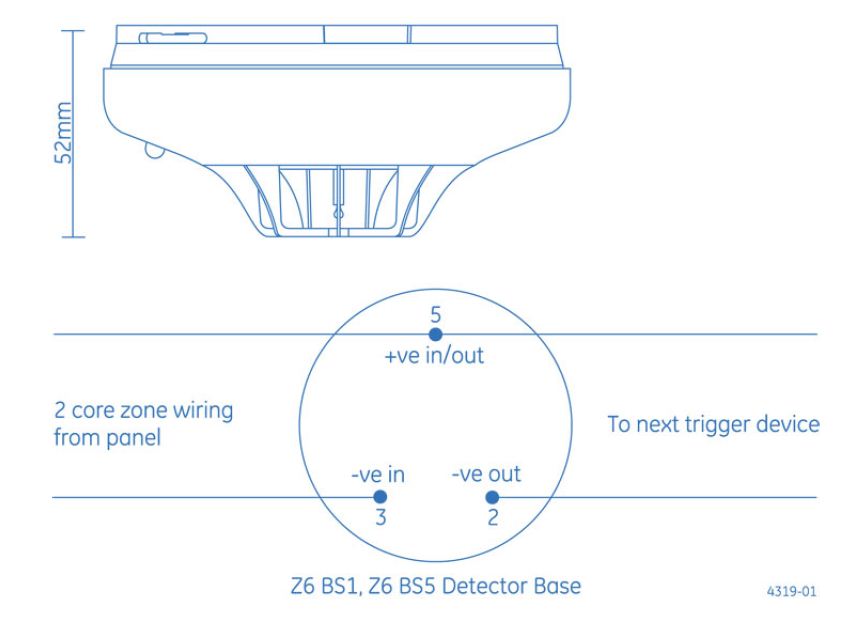

sorry ,How can I use SIGA IM,I think U mean SIGA UM?
I try the SIGA UM but the SIGA UM monitor the device with comon - (negatif) not comon + (positif)as it is in the case of the ziton device.

It work very well on a siga UM personality code 13
