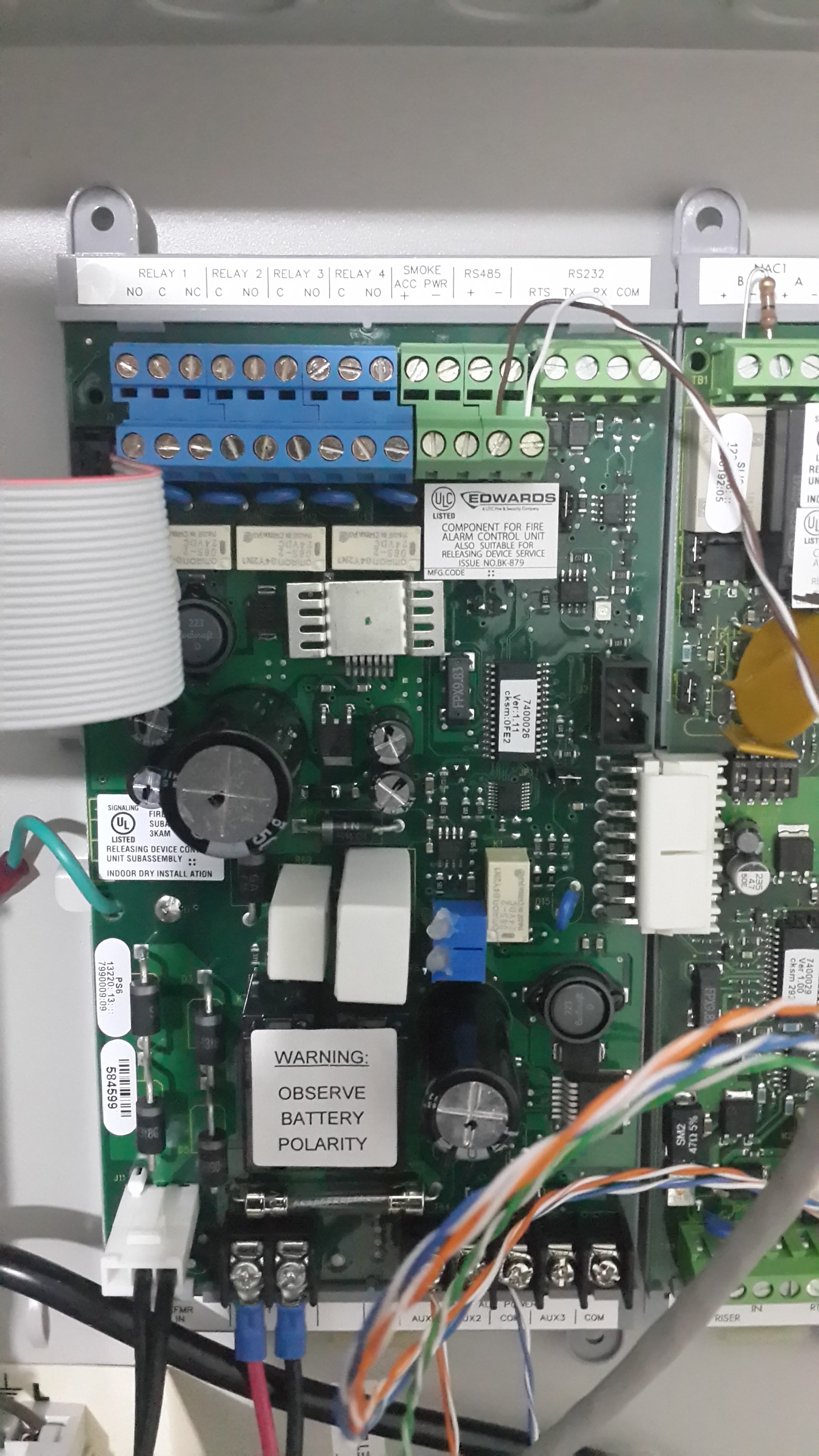

Hi All,
I just received one QS4 and one Annunciator QS4-CPU 2, both V:2.5, i used the autolearn and i did step by step, as the reference manual mention.
and i'm not able to establish a communication between them.
Error details:P:02 C:00 D:005
Ann 02, CH1
Communications
Same error in the QS4 Panel; I re-verified the OS version, and i used the Codeloader, and i did all the step again and again.
PS: on the PS6 / RS485 installation wiring diagram they mention the lower connector (From previous annunciator) and in the reference manual they are reversed, they mention to Next annunciator.
Hope to get an assistance asap please.
