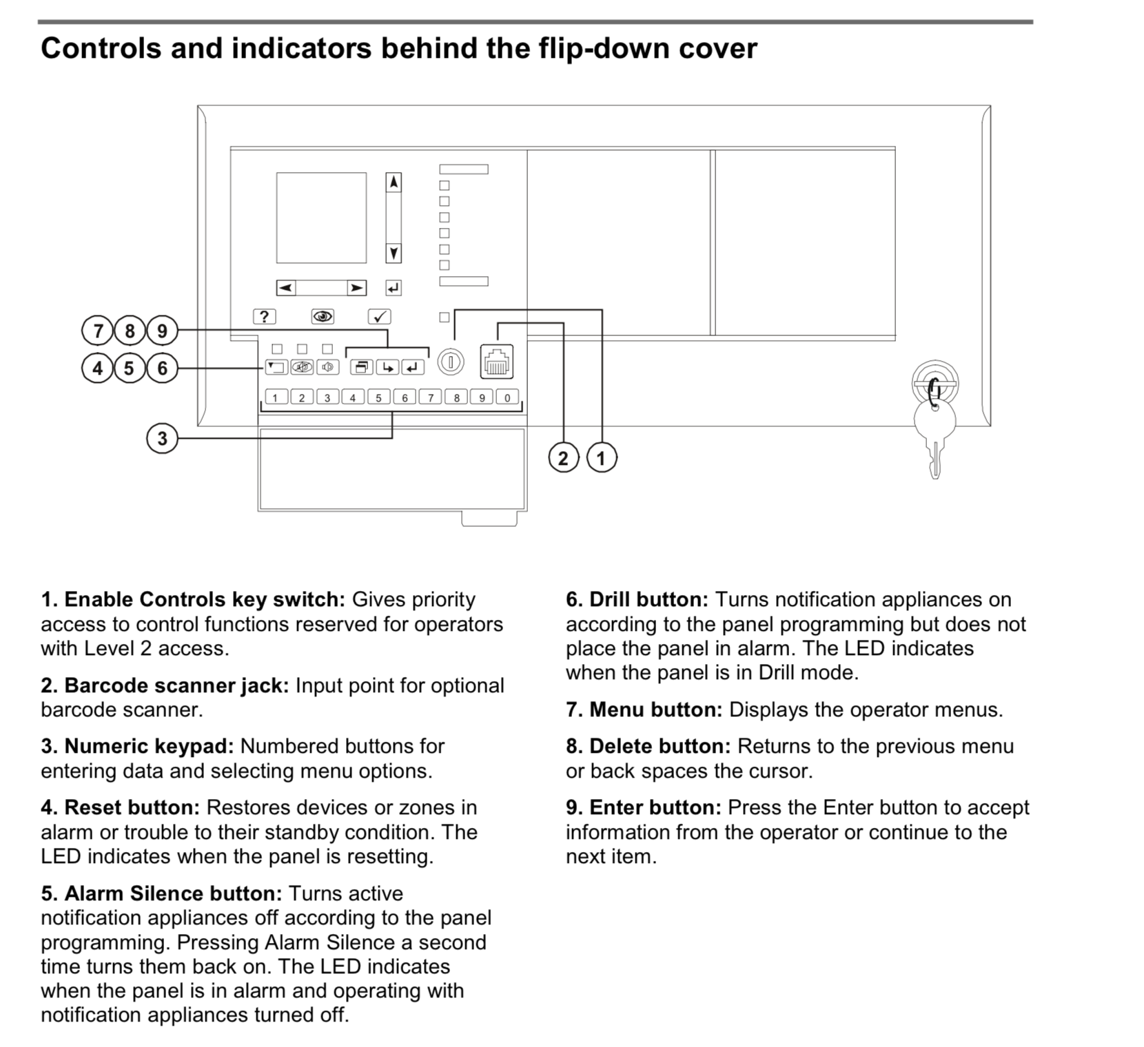

Anyone know where to pick up the barrel key for this panel? My customer is demanding a few for the panel and the knox box.
Item 2 in the picture.

I can not view the attached file.
can anyone view it.

no link to click on the attachment. I'm assuming your looking for the barrel key? Not sure where to get them to be honest. They're always left with the panel. Sometimes I find them sitting inside the panel.
