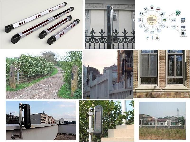

There are three types beams system. They are infrared beams, infrared grating, and infrared light wall. They are applied at different situation. Infrared beam is installed on wall or fence. It has 3 Infrared light wall beams or 4 beam, 6 beams and length is short compared with other two types. So, it should be installed over the wall or fence or with bracket and pole to get enough protection height. But it has maximum 100 meters detection length. Infrared grating is used for windows, balcony or gate. It has 4 beams or 8 beams and with 620 mm to 1200 mm. The detection distance is 10 meters only. Infrared light wall is used for fixing on ground and can have lamp on cover.
applied project of solar power beam system
