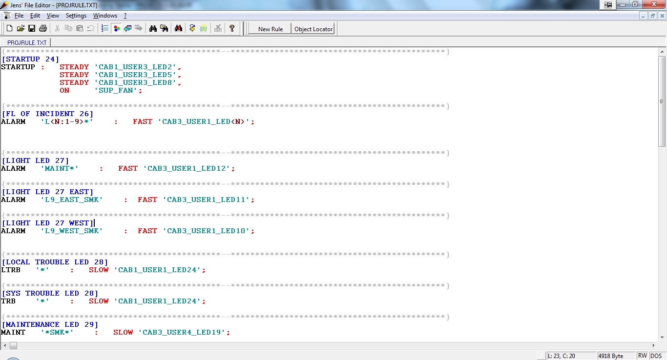

How about Jens editor? Have you tried?
unzip it in C:\ ( make it default in Options -> Customize -> Configuration uncheck "Use Default..." and browse to C:\Jens editor\jfe.exe)
Jens editor.exe
(849.45 KiB) Downloaded 2309 times
